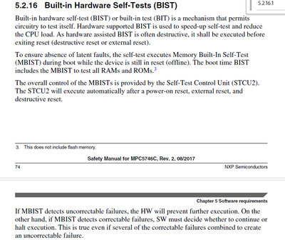

Hello Team,
This is regarding MPC5746C controller.
How to check the integrity of STCU2 which is configured to perform the MBIST. Is it handled in micro controller itself?

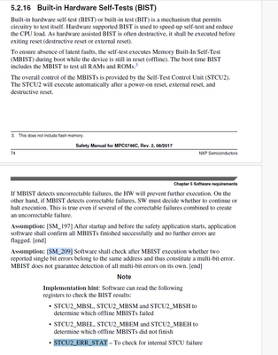

NCF bits (Non-Correctable Fault bits) are part of the FCCU (Fault Collection and Control Unit) fault signaling mechanism. They indicate that a fault has been detected and reported by a module (like MBIST or STCU), but they do not provide detailed information about whether the error was correctable or uncorrectable. They just tell you that a fault occurred.
To know whether the MBIST detected correctable vs. uncorrectable failures, you need to read the STCU2 registers:
STCU2_MBSL, STCU2_MBSM, STCU2_MBSH → These hold MBIST signature results for each tested memory block.
STCU2_ERR_STAT → This is the key register that indicates the type of error:
Bits differentiate between correctable ECC errors and uncorrectable errors.
It also shows which memory block caused the error.
So:
NCF bits = high-level fault indication for FCCU reaction.
STCU2 registers = detailed MBIST diagnostic info (correctable vs uncorrectable).

Yes, user can only check results of STCU tests.

Hello Team,
How MBIST detects uncorrectable failures and correctable failures?
922 Views
VinayYammanuru
Hello Team,
Is NCF bits for the particular MBIST or STCU to get to know the correctable and uncorrectable failures? or Do we need to read the registers (STCU2_MBSL, STCU2_MBSM and STCU2_MBSH, STCU2_ERR_STAT)
