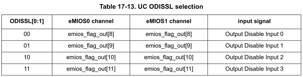

I tried to use MPC5645S emios to generate SW triggered PWM signal.
According to mannual I can use ODIS and ODISSL bits to do so. but it doesn't describe clear how?
I didn't find any idea about output disable input 0, is this a real pin or internal connection?
can anybody help with an example?
Best Regards
Yinping
1,214 Views
davidtosenovjan
Hi, it is not pin, it is internal signal driven by FLAG of channels 8-11 as described in table below:
