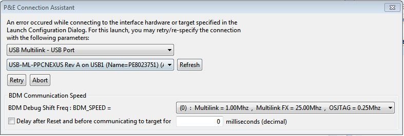

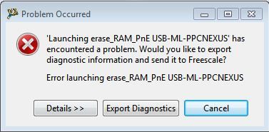

snehakalkhair
Hi David,
Following is the sequence of the errors i get when i try to execute the flash erase program.
Can i try uncensoring it using the serial boot mode?
