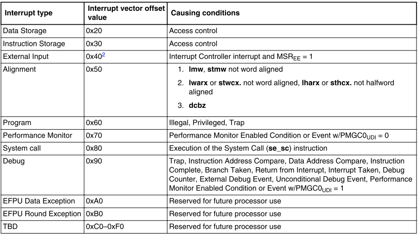

This is described in reference manual : Table 59-7. Exceptions and Conditions
Here you can see the causing conditions for each exception.
If you want for example call IVOR6:
Call jump to memory location where is no instruction stored: like below
Executing opcode 0xFFFF - undefined instruction will lead you to IVOR6 exception.
If you follow the table 59-7. you can call other exceptions.
Peter

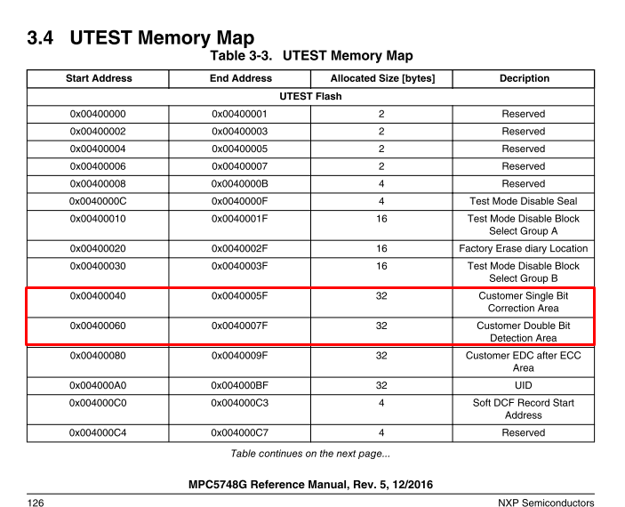

I expect that your micro is MPC5748G, not MPC5648G.
On MPC5748G there is already preprogam flash ECC single and double bit error in Utest flash.
You can test reaction on flash errors by reading this address in UTEST flash.
Peter

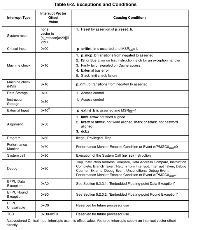

Please read e200z4 core reference manual to see the exception details:
Peter
