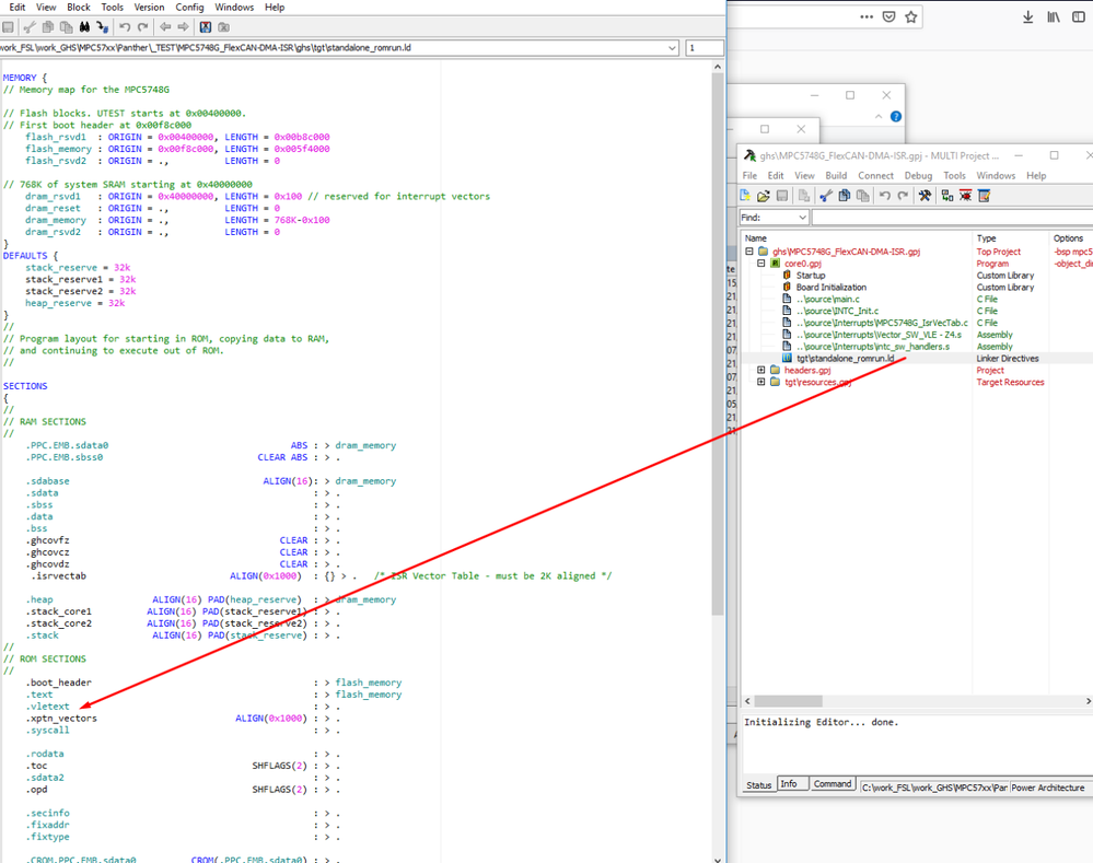

Hi All,
Currently i'm using the sample code from NXP community for MPC5748G.
Can anyone please let me know how i can check the code is flashed into FLASH or SRAM memory?
How to change the code to program into FLASH memory?
I have attached the sample code which i'm using.
Thank you,
Babu Dudekula
Tags (2)
1,241 Views
petervlna
The code is loaded into Flash, you can see it from the Lauterbach cmm file or from linker file.
As you can see from map file:
your VLEtext section is in flash and there is also your code.
regards,
Peter
