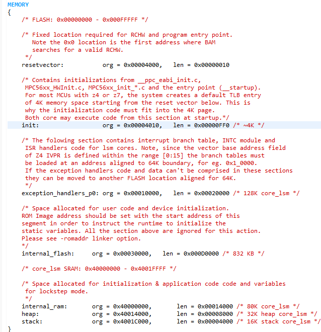

I just did what yo suggested. Actually I changed the reset vector original address from 0x00000000 to 0x00004000 and init original address from 0x00000010 to 0x000004010 in the memory.
And then  i was able to get the value loaded in the desired location.

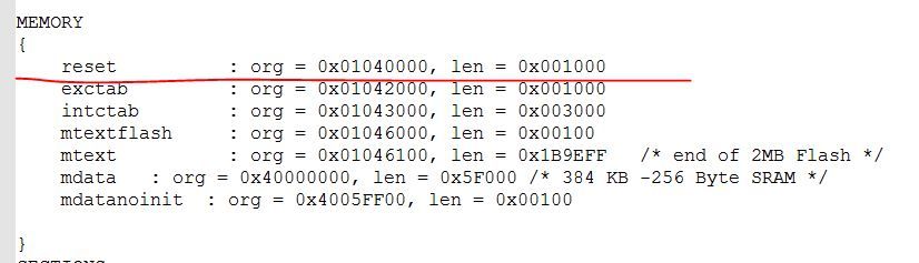

Firstly, you can see the figure below which is captured from the link script file. Gennerally, we set the RCHW in the startup file  but the address is declared in the ld file ,  look the content which I mark with red pen, I set the 0x01040000 as the reset address, So our code will be programmed from 0x01040000, and execute from this address. if you want to set the 3rd location as the start address. you can try this method. Wish this help you. And please tell me the result.capture.JPG

arthivenkatasub
Hi Sir,
Thanks for your reply. Sorry for the delay. It is working correctly.
