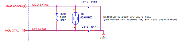

My cpu is MPC5748G with Z4_0.According to the datasheet,the Cpu core clock can up to 160M(HZ).
my circuit is that:

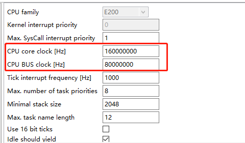

When I use lwip_5748G demo project running in the core,the fasted bandwidth perform differently with diffrent CPU core clock setting.
the fault setting is like this:
On this case, the bandwidth can up to 3.9M.And the cpu timer is not accurate.
when I change the setting like this:
the bandwidth can only up to 1.2M.And the cpu timer is much more inaccurate compared with the default setting.
Can someone explain that condition for me ? And how could I set the CPU core clock and CPU bus clock correctly?

the screenshot of your settings suggests that you are using very old version of SDK - I guess it is EAR 0.8.1, isn't it? The configuration has been changed and it could be the root cause. Currently there's version RTM2.0.0, so I would suggest to download latest Update 9:

     My question is that Could I set the cpu core clock to 160M HZ ,while the freqency of the external Oscillators is 40M HZ ?

yes, it's highly recommended to use the latest RTM version.
And yes, this will help to reach highest performance. By the way, this configuration is used in lwip demo code in RTM version 2.0.0.

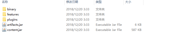

    I have download the lastest update packet with the version of RTM 2.0.0 from nxp web station.
   When I open the packet, there're several files like following:
   There's no executable file. My OS is Windows 10. How could I use this packet to upgrade the SDK to RTM 2.0.0?

see please this link, section Installation Instructions:
