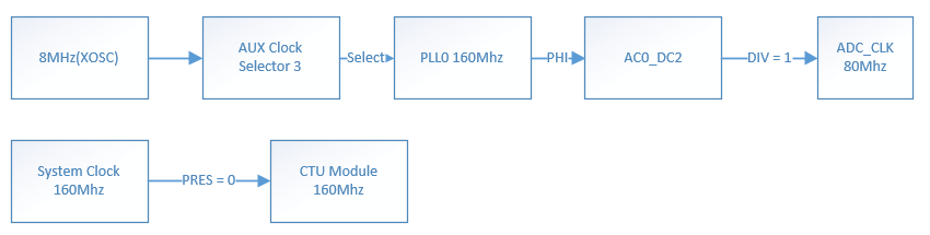

      Take the following example to describe the problems we encountered:ADCandCTU_CLK.png

the calculation look correct and the timing could be right. Anyway it seems some clock could be twice less, so I can recommend to double check if the CTU and ADC clocks are as you stated. Is the ADCLKSEL still set?
If you enabled CTU trigger output you can check on the pin the trigger generation, to see the timing.
Finally, you selected dual conversion, however no setting for ADC1 is mentioned. Is this the same as for ADC0?
BR, Petr

    Petr,According to your prompt, I have paid attention to the configuration of ADC clock again.
    In my code, the operation on ADCLKSEL was implemented directly by operating the MCR register,
      pADC_0->MCR.R = 0x00000001U;
      pADC_0->MCR.R = 0x80020100U;

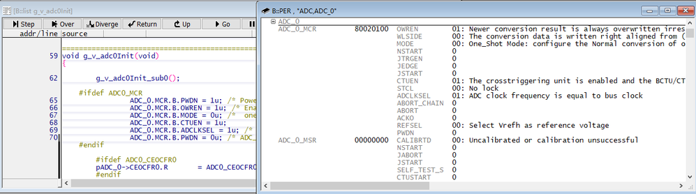

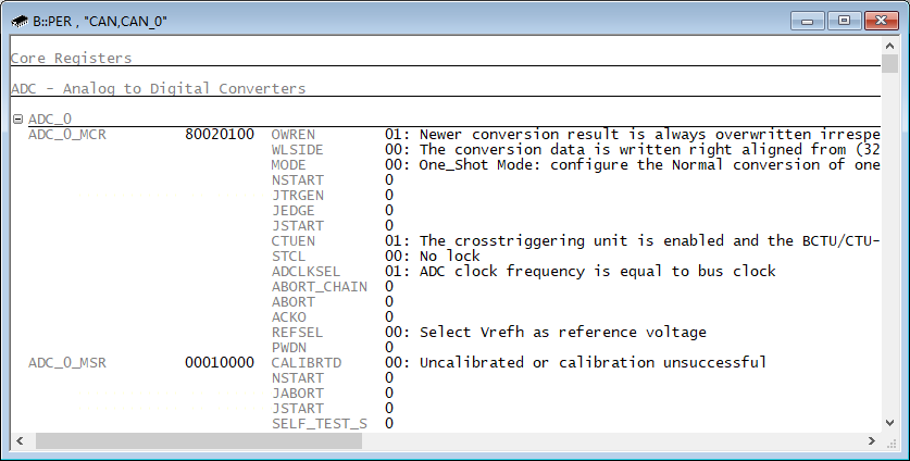

     and then I also debugged with the debugger, which showed that the value of the ADCLKSEL bit in the MCR register was 1.修改前劳特巴赫截图.png
However, through a series of experiments, I found that my ADC clock was configured as half bus clock(40MHz).

The debugger debugged the results:修改后劳特巴赫截图.png
According to this code design, the tested ADC clock is 80Mhz, and the time to sample a set of AD data is consistent with the theoretical value of 1us.
Therefore, I would like to ask if there is any way for 5741 chip to determine whether ADCLKSEL is written and effective.Because from my experiment, the debugger didn't look right.
3,048 Views
PetrS
 MCR[ADCLKSEL] can only be written in power-down, when MCR[PWDN] = 1. So the second code ensures that, I think.
You can try to enable DUALPORT in Lauterbach and see a difference.
