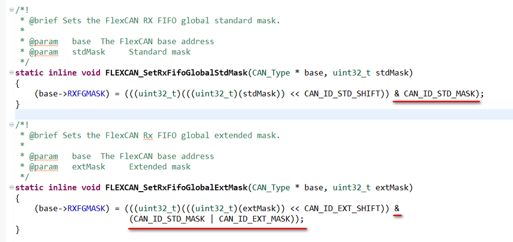

I want to receive message with specific ID .For instance 0x000,0x111,0x222 and so on.
  • The can configuration is as follows:
  • The can_fifo_config is as follows:
  • I send message to my device from ID 0X000 to ID 0X7FF,while the device receives something that is not in my expectation.
As follows:
It seems that the mask highest bit is not in effect.

Because of the RX FIFO,it is right that to configure the CAN_RXFGMASK as 0x1fffffff. [0:28]
However there are some mistakes in somewhere.
Then I force CAN_RXFGMASK to be configured as 0x3fffffff. It does work.
Is there some mistakes in my knowledge?
where is mistake?Please inform me in detail .

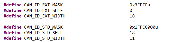

mask within a RXFGMASK should be shifted left by 1 bit as you can see in chapter 43.4.17 of the RM
so, to have exact match you need to set RXFGMASK = 0x3FF80000 (assuming standard ID is received).
Most probably the driver function does not shift the value properly.
With the RXFGMASK = 0x1FFC0000  the MSB of the ID is don't care, that's the reason you received such IDs.
BR, Petr

Thank you for your reply.
Yes,you are right.
There may be a bug in the SDK.
The API(settting Rx FIFO global mask) dose not deal with CAN_MCR[IDAM] .
It only checks either standard id or extended id,but it is useless for CAN_RXFGMASK.
And it will clear the bits form 31 to 29. So it is never correct that use the API(FLEXCAN_DRV_SetRxFifoGlobalMask) to configure the CAN_RXFGMASK.
Best regards,gao
