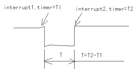

Hello,guys. now I get a problem.
First, I configure  eTPU channel 24/25/26/27 as input capture,the code is as follows:
     errorCode = fs_etpu_ic_init(24, FS_ETPU_PRIORITY_HIGH, ETPU_IC_MODE_CONT, FS_ETPU_TCR1, ETPU_IC_ANY_EDGE, 1);
then, I used these channels to calculate the pulse width (T),the principal is as shown below,
and the code is as follows:
if( edge ==  CONF_EDGE_RISING )
       numTcntEnd = 0x00FFFFFFUL & (uint32)fs_etpu_ic_read_final_time(24);
       if(numTcntStart  <= numTcntEnd)
            PW = numTcntEnd - numTcntStart;
       else
            PW = 0x00FFFFFFUL - numTcntStart + numTcntEnd;
else
     numTcntStart = 0x00FFFFFFUL & (uint32)fs_etpu_ic_read_final_time(24);
Later, when MCU was running, PW is calculated correctly.
But when I  configure  eTPU channel 0/1/2/3 as QOM output, and were performed in interrupt2(see picture1),then PW is calculated mistakenly sometimes. The code of set qom output is as follows:
ETPU.CHAN[0].SCR.B.CIS=1;
errorCode=fs_etpu_qom_init(0,FS_ETPU_PRIORITY_HIGH ,FS_ETPU_QOM_SINGLE_SHOT,FS_ETPU_TCR1,CONF_IGN_IDLE,FS_ETPU_QOM_IMMEDIATE ,0,1,2,event.Ign[x]);
It's very strange, and I get no idea to solve it, can you help me?
Thank you very much for your attention!

davidtosenovjan
Could you describe some details about faulty behavior? What number have you obtained? Have you tried to change channel priorities?
