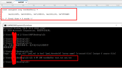

Thanks,the IDE tool I use is CodeWarrior 10.5.
As you said, there is a MOT file but how do I use s2C?
How do I convert a function into an array using this instruction?

I do not have documentation for the tool, just follow the description of arguments. I believe you will figure it out after a couple of experiments. Example:
s2c 4 FF 100 test_c_array whatever.mot output.txt
And as I mentioned, put your function to some specific segment, so you can easily find in in the s-record ifle and then separate required part of the s-record to another file. This file then use with the tool.

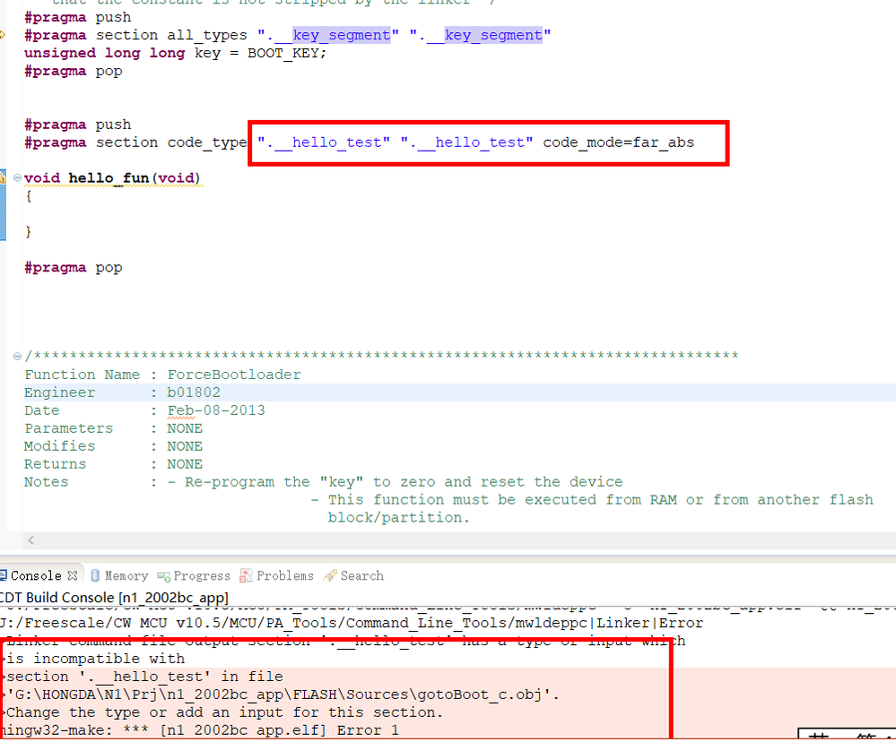

There is an error in the above image. Here is the updated image and the compiled result.

Sorry, I have another problem, I can't put a function in a paragraph.I can only put one variable in a paragraph.Can you tell me how to put a function in a segment?Thank you very much!

this is how to put a function to specific flash segment and to specific RAM segment (the code is copied to RAM by startup files):
MEMORY
hello_test: org = ..., len = ... //flash segment
code_ram: org = ..., len = ... //RAM segment
SECTIONS
.__code_ram (VLECODE) : {} > code_ram
.__hello_test (VLECODE) LOAD(ADDR(hello_test)) : {} > hello_test
And in C file:
#pragma push
#pragma section code_type ".__hello_test" code_mode=far_abs
void test(void)
asm("nop");
#pragma pop
#pragma push
#pragma section code_type ".__code_ram" code_mode=far_abs
void test_ram(void)
asm("nop");
#pragma pop
Lukas

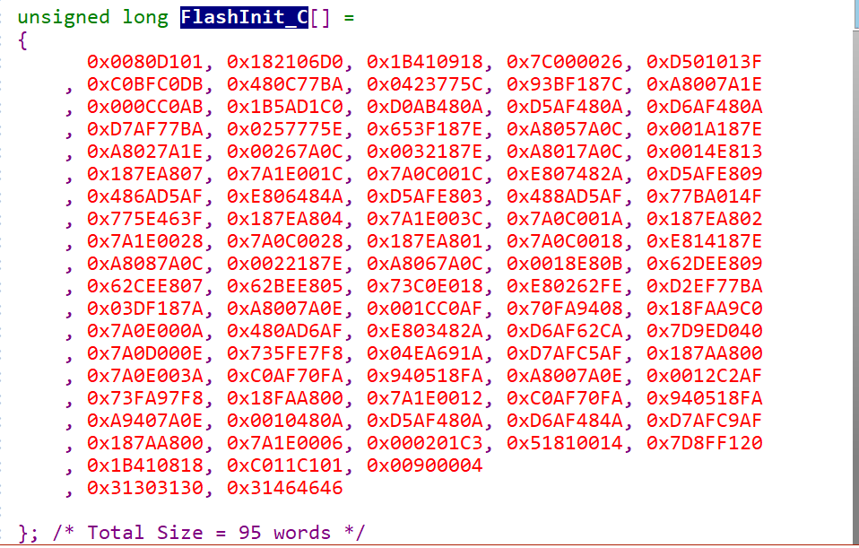

Finally, I get an array by s2c
test_fun didn't work properly.
Looking forward to your reply,Thank you very much.

The program did not work normally after s2c.exe conversion.
