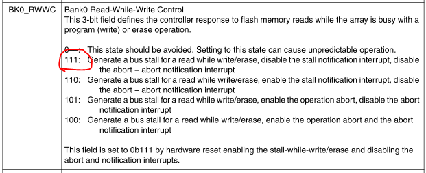

lukaszadrapa
it looks like you erased the flash where the code was running from. Could you check that?
Have you changed the default platform flash controller setting? Default settings is enabling the stall-while-write/erase and disabling the abort and notifications interrupt. So, the read operation will be stalled until on-going program/erase operation to complete. That means it is not necessary to run the command from SRAM or from another flash block. (notice that this is valid only on devices like MPC5602C which has C90LC flash).
Lukas
8,193 Views
anegoiko
Thanks for your answer. The truth is that I did not change the default settings, at least not in purpose. How can I know if I have changed thouse settings?
8,194 Views
lukaszadrapa
Run your initialization and then check the registers PFCR0 and PFCR1, bit fields BKn_RWWC. All mentioned bits should be '1' (default state).
Lukas
