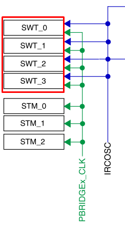

Can you descirbe clock source for HSM_SWT and add reference to documentation?

SWT is supplied by IRC and its registers by PBRIDGE clock as reference manual describes.
Peter

Thank you. I checked it through experiment ...
Martin
