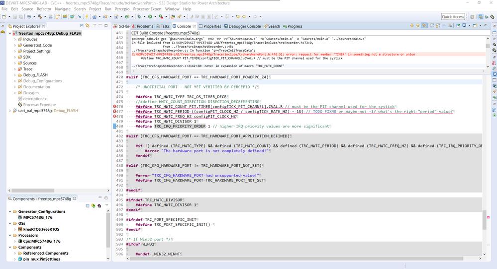

I am using freeRTOS on MPC5748G, I want to add trace files but I have this error and I don't have any idea about the source of this error.
I am getting started with a power pc micro and I am asking for help, please.
Thank you in advance for your Capture d’écran 2021-05-24 200120.pngCapture d’écran 2021-05-24 200120.pnghelp,

try to use
PIT->TIMER[...].CVAL
This should work.
