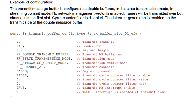

Hi all,
I try to find function about Flexray Cycle Repetition and Base Cycle. But I don't know which function should I use.
Is there any function that can accomplish Cycle Repetition and Base Cycle?
Thank you.

Regarding configuration of FlexRay driver, the configuration of message buffers is done in function Fr_buffers_init
which parameter is the pointer to the MB configuration structure. Fr_transmit_buffer_config_type is used for configuring the whole TX MB parameters.
for question the cycle filtering needs to be set
Peter

Hi petervlna,
I tried modify the cycle value and cycle mask, and I got the result as follows:
value: start cycle count=> It's fine.
mask: 0x000000=>every cycles
0x000001=>2 cycles
0x000011=>4 cycles
0x000111=>8 cycles
0x001111=>16 cycles
0x011111=>32 cycles
0x111111=>64 cycles
And I can't get cycle 5,10,20,40,50. Do you have any suggestion?
Thanks.

kevin198776
Hi Petervlna,
I'm using the MPC5604P StarterTRAK (Development Kit).
I generated base code from RAppID and porting flexray driver from the example "FlexRay UNIFIED Driver and Application Example". I didn't find any function or register about  "Cycle Repetition and Base Cycle" in this example.
Could you give me some advice? Thanks.
