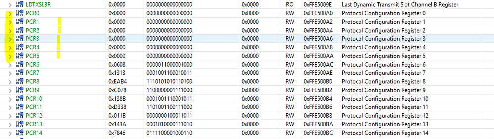

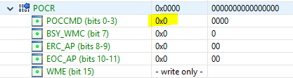

But when I click on "Resume or F8" I can see few of the Protocol Configuration Register (PCR0 to PC5) are set with 0x0000. See below image 1.
If I perform "Single Step (F5)" debugging I can see these PCR are updating with required values.See below image 2.
Do I need to give some delay before configuring this Protocol Configuration Register?

But another observation is after starting communication (RUN command) the cycle counter is 0. So cycle counter value will increment once another node sends start up frames ?? My understanding is after RUN command cycle counter will start increment.
Also after sending POC command WAKEUP the PROTSTATE is not changing to POC:wakeup (010 ) it remains in READY state. Below images of are taken immediate after sending WAKEUP command. I assume that communication controller process WAKEUP command very fast and updates READY state before it display on peripheral registers in the EmbSysReg tab.
Also with reference to below diagram for leading cold start node start up states will be,
READY -> COLDSTART LISTEN -> COLDSTART COLLISION RESOLUTION
But with one node after sending POC Command :  ALLOW_COLDSTART (0000)  i can see it as,
READY ->  INTEGRATION LISTEN
Before POC Command :  ALLOW_COLDSTART (0000)
The POC state is in READY and Start up state is 0x00
After POC Command :  ALLOW_COLDSTART (0000)
After this command giving some Delay and starting communication with RUN command the startup state immediately changed to INTEGRATION LISTEN.
So all above observations will get resolved after integrating with another node ??
