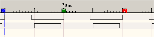

I want to use FlexPWM on the TRK-MPC5604P board to trigger an analog sampling.  I'll eventually use the cross triggering unit (CTU), but it has been giving me headaches to figure it out, so I thought I'd try something easier, just to get something running.  I'd thought I'd just use an interrupt service routine on Val(n) matches.  I've setup FLEXPWM0 on Module 2 and I can observe the A&B wavforms, (centerlined), and I can change the dutycycle on the fly from a serial interface.  So the FLEXPWM_0.SUB[2].VAL[i].R are all setup properly and working.

and I added the interrupt service routines, and enabled the external interrupts using ( asm(" wrteei 1"); )   This also includes a period interrupt timer PIT.  After compiling, I can debug this on the target using CodeWarrior for MCU (V10.6 Eclipse).  I can set a breakpoint in the PIT interrupt service routine and break on the interrupt.  But I cannot break in either of the two PWM0 interrupts service routines.  It's as if the interrupts are never generated.
