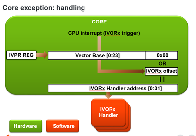

I have a question,
Does the MPC5744P microcontroller support flash vector table reroute ??
Thanks a lot.
1,253 Views
davidtosenovjan
Do you mean interrupt vector table? Please clarify
1,251 Views
abdelrhman
yes I mean interrupt vector table
1,248 Views
davidtosenovjan
Yes, base address is given by IVPR register that is configured by MCU startup file.
