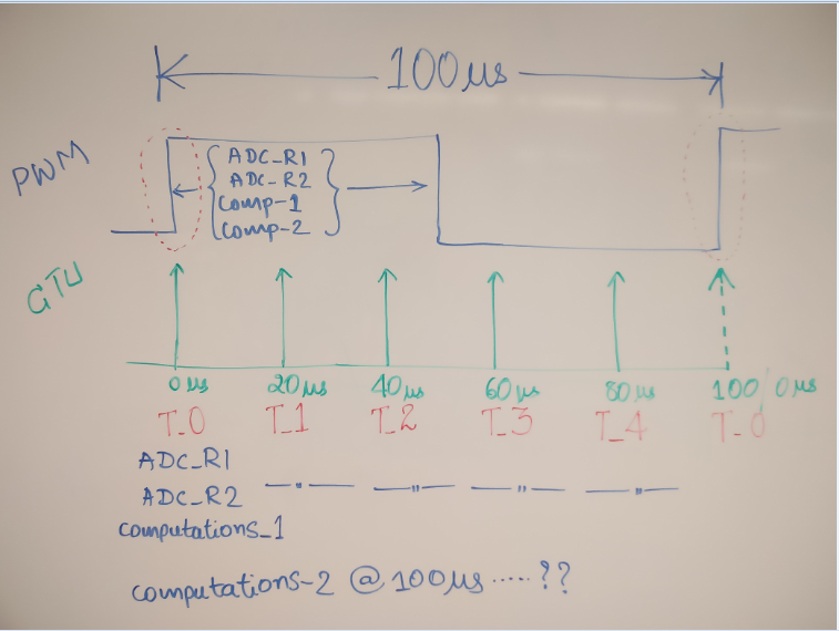

petervlna‌, I think I did not explain clearly what I am trying to achieve.
Currently: Every 100us Task_A and Task_B gets executes. CTU triggers ADC and upon ADC completing conversions, an interrupt is generated to take care of both the tasks.
Change Required: Now because of component change, Task_A needs to run at every 20us and Task_B needs to run at every 100us. With both solutions you suggested, no doubt I can get to execute Task_A at every 20us by triggering an interrupt; But I still need an interrupt to run Task_B at every 100us. I cannot simply execute this Task_B at every 5th instance of 20us interrupt because Task_B is longer than 20us. So, I need another lower priority interrupt to do Task_B.
How do I do that is my question.
Please suggest how do I achieve the above with those 2 solutions. Also, please tell me if my option stated above works as well.

sagardhavali
Hi petervlna,
  • Yes, I need both Task_A and Task_B in synchronous
Here is what I am trying to do:
Currently, all the computations are done in 100us. Say those are: ADC reads ADC_R1, ADC_R2 and computation Comp_1 and Comp_2.
Note: Please don't assume that all these tasks take just 50us. I have it marked wrongly in the following picture.
Now, I would want to handle all those tasks differently as follows.
  • I can use CTU to trigger 0 to 4 to generate 5 interrupts at every 20us. In these ISRs, I can do ADC-R1, ADC_R2 and Computations_1.
  • That leaves me to do computations_2 at the same 100us interval. And, I need this to be done in a different ISR and in synchronous with those CTU trigger interrupts.
Question/Clarification:
  • I want to accomplish computations_2 in the same old 100us ISR. I don't want it those executions be done at every 5th instance of 20us.
  • How do I get that 100us ISR set up?
  • And I want it to be in sync with CTU triggers.
Thank You,
Sagar
