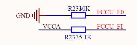

Now configure the FCCU registers in initialization function,there eout pin is in fault state.However there is no fault inject,and the eout fault state can't exit.Why the eout pin is in fault status while there is no fault?And how to change the eout pin to normal state?

Are you observing fault state before or after you configure FCCU EOUT?
It would be helpful if you share with us also your connection with \SBC fccu side.
Also the pull resistor used.

First of all,we use the pull resistor.
Before configure FCCU EOUT,the F0 is in low voltage,the F1 is in high voltage,this mean the normal state.
However,when configure FCCU.CFG.B.FCCU_SET_AFTER_RESET = 0x1,it goes into the fault state(the F0 is in high voltage,the F1 is in low voltage) and can't exit the state at all.
I am confused why and how to exit the fault state,and whether there is something wrong with my configuration.

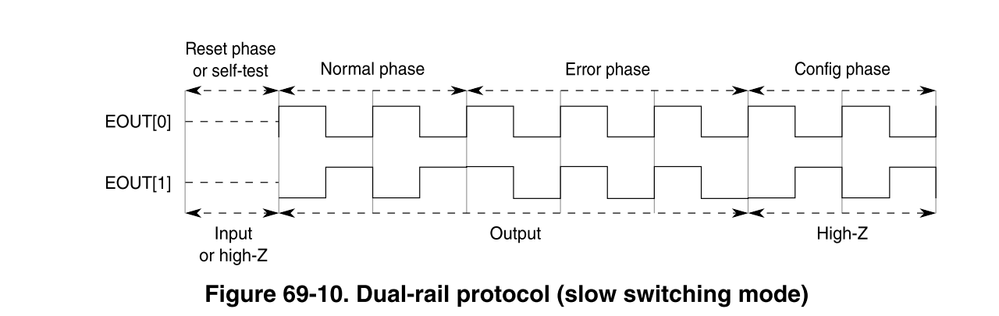

By default FCCU use Dual rail switching protocol:
Unless you configure FCCU CFG by DCF record.
So, this is fault state. Did you configured DCF record for different protocol?

I configure it to Bi-stable mode.
When the mpc5744 goes in normal mode,why it the F0 is in low voltage,the F1 is in high voltage?
