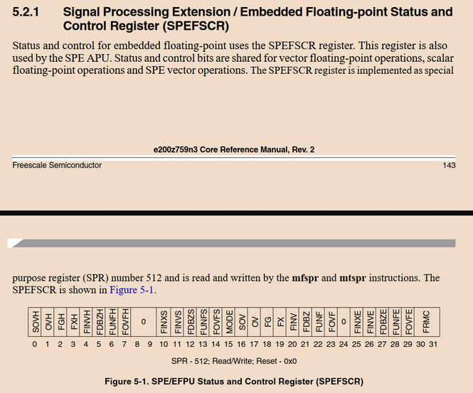

What is your setting of SPEFSCR register?
2,678件の閲覧回数
kwru
I configured FINVE/FDBZE/FUNFE/FOVFE using the SPESFCR register.
When I check the register, however, it shows SPESFCR = 0x0020303B (FINXS/FG/FX/FINVE/FDBZE/FUNFE/FRMC(11)).
It is strange that the FOVFE setting is not reflected even though I enabled it.
2,648件の閲覧回数
davidtosenovjan
I have tested it with MPC5674F having the same core (MPC5777C I don't available jut now) and I have set all bits in the register. I guess you could have some problem in your assembler code.
2,439件の閲覧回数
kwru
Thank you for your reply.
How was the SPESFCR register configured, and how was it actually set?
What exactly does it mean that all the tests were successful?
When the FOVFE in the SPESFCR register is enabled, does an exception occur in test case No. 1 above?
