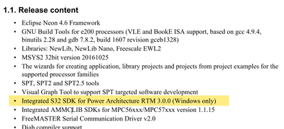

Ah, I am a Linux user, and it seems like there is no SDHC example on the Linux version of S32DS. Could you provide me any resources also available in S32DS for Linux? (Just sharing the example file will be also welcomed!)
2,946 Views
lukaszadrapa
I have bad news... The SDK is integrated only in Windows version:
Unfortunately we do not have other examples than this one in SDK.
