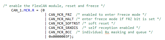

I am having issue getting the CAN Example for the MPC5746R to work?  I am using the 57XX mother board with the MPC5746R-252DS.  I would expect that this example would just work.
I have verified that the pin jumpers J37 and J38 are in the 2-3 position.   I have also tried with them in the 1-2 position.
I am using s32DS 2017.R1 and an iSystems debugger.

flyskyr丶
Hi Ron,
I found and solved this problem.
When using your configuration
MAXMB in this register is not set to 0x3F successfully, it is 0xF. Because of that "This field can be
written only in Freeze mode because it is blocked by hardware in other modes". Only 16 MBs can be used in this case.
So I add that "CAN_1.MCR.B.MAXMB = 63;". Now , 64 MBs can be used. it's fine.
