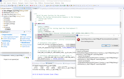

"Error starting process.", This problem always occur when I run any program.
Looking forward to your reply

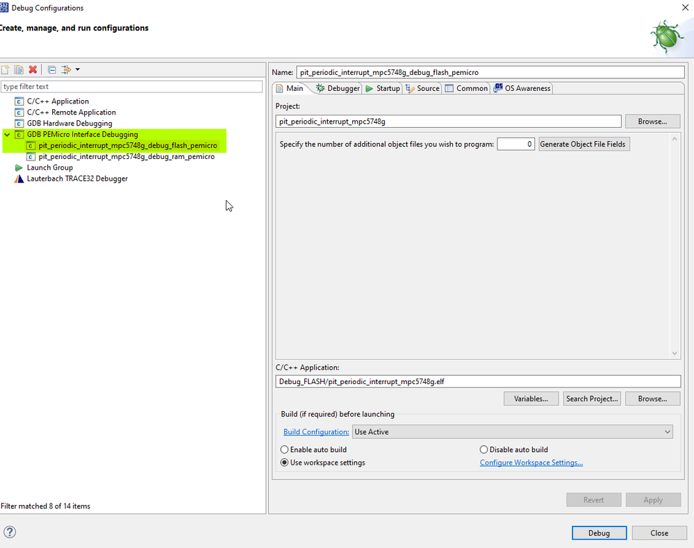

please make sure that you selected GDB PE Micro interface. It looks that you are trying debug the .elf file as a x86 executable.
Jiri
1,514 Views
Hanry
Thanks for your direction. Best wishes for you.
