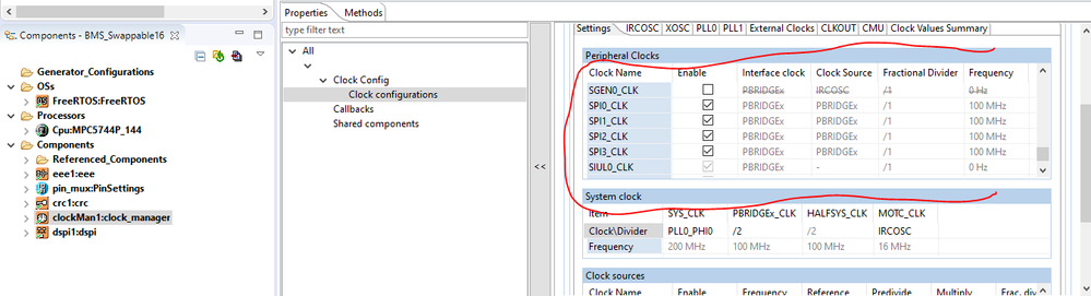

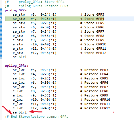

I encounter this error in SPI Initialization (in spi driver, automatic code generation). i will post screenshots of exact error location
then it shows this image..

be sure used SPI module has its module clock enabled.
BR, Petr

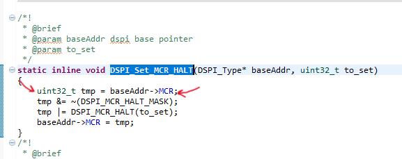

PetrS
yes, that is a setting in the PE, but if DSPI1 module is used check within debugger MC_ME_PS3[S_DSPI_1] register bit if module is active or not. If it is clocked then check address accessed in DSPI_Set_MCR_HALT.
BR, Petr
1,638 Views
ismael-wael
it is, isn't it?
