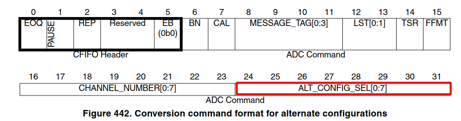

If I understand well you want to change resolution to 8-bit.
It can be done by choosing Conversion Command Format for Alternate Configurations, it the such one having 0x08-0x0F on LSB place.
For instance 0x08 choose Alternate configuration 1 that is related to ADC_ACR1 register
I would recommend to see following example code:
Example MPC5674F eQADC+eDMA Single_Scan CW210
I am using there header file called eQADC_macros_MONACO.h which you possibly simplify you configuration.

uint32_t CQueue_0[] =
    ( ALT_CONFIG_SEL(ALT_CONF_1) | CHANNEL(0)  | MESSAGE_TAG(RFIFO0)       ),
    ( ALT_CONFIG_SEL(ALT_CONF_1) | CHANNEL(1)  | MESSAGE_TAG(RFIFO0) | EOQ ),
It is not all necessary changes but I hope it helps a bit.

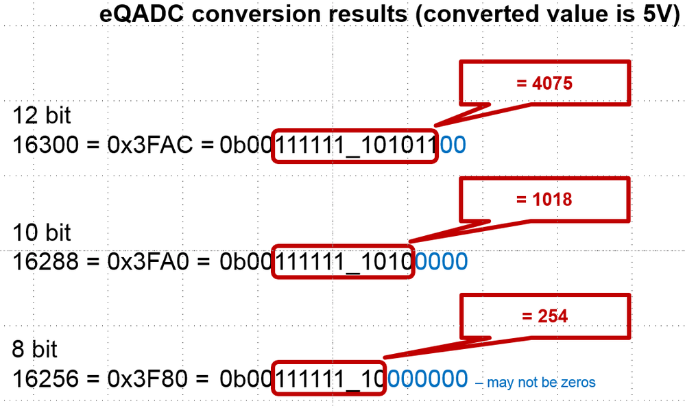

One yet note about result format (as it be possibly confusing) - it is basically placed in the middle of result register like in this examples :

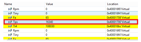

I change it in Alternate configuration 0x08 but the values I get remain the same as 14 bits as the image.
I have the code as well.
Does not change to 8bit
It is better a resolution of 14 bits as the one I get or 8 bits is for the calculation of the times of injection of a motor

It is needed to mask results as I depicted by red color. otherwise you have just 14-bit result but never 14-bit accuracy.
The only reason for choosing 10/8bit is shorter conversion time by one/two adc cycles.
