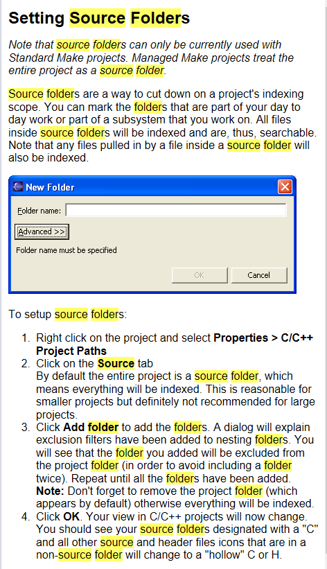

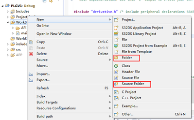

1 Problem: It confuse me that what is the difference between Folder and SourceFolder.
2 Problem:Different choice has different results.What is the difference below?

You can read it in help of S32DS:
Peter
