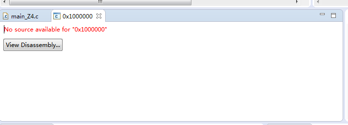

Hello everyone , recently I find some problems in MPC5775K  when I debug the program , it always comes out this :
168900_168900.pngpastedImage_1.png.
Is there anyone knows how to solve this problem? I'm looking forward your reply , thanks very much

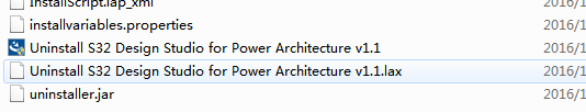

I have checked the software, it's version 1.1 with there is shown as below:
pastedImage_1.png.
And I'm not sure if there is any plugin in S32DS , I got the software from Freescale website , and I did not do any changes.
Recently I try to debug the project about SDADC, in fact this project can be debugged in my friend's computer , who created this SDADC project in his computer first , maybe is this the main reason ?

On the picture you shared I see, there is main_z4.c tab. Is this tab also related to your project? The tab with 0x1000000 appears immediately after you connect to microcontroller, or are there any conditions that must be reach to appear this tab (for example some IVOR exception, or switch to some file)?
Have you checked you do not use absolute paths in the project? It would explain the behavior that your colleague is able to debug the project and you are not, because he created project and maybe added there some files which could have different path in your computer. Please open project properties and check.
I suppose you use the same versions of S32 Design Studio (both version 1.1).
