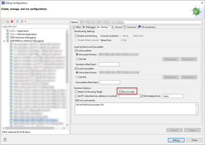

well, this looks like something went wrong in startup files. To find more details, go to Debug Configurations and uncheck "Run on reset" option in Startup tab:
In this case, the debugger will stop the code directly at entry point and then you can step the startup files to see what caused the problem exactly. I'm not really sure what's going on, I would need more details.

Hi Lukas,
It seems nothing changed after I unchecked the 'Run on reset'.
