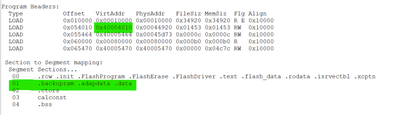

I found out that this change affects the segments LOAD in my elfdump.txt file. I'm trying to getting familiar with the program headers and memory mapping. and I discovered that the program headers are now 6 instead of 5.
before my change I had these LOADs:
Program Headers:
Type Offset VirtAddr PhysAddr FileSiz MemSiz Flg Align
LOAD 0x010000 0x00010000 0x00010000 0x34920 0x34920 R E 0x10000
LOAD 0x054010 0x40004010 0x00044920 0x0144f 0x0144f RW 0x10000
LOAD 0x055460 0x40005460 0x00045d6f 0x0000c 0x0000c RW 0x10000
LOAD 0x060000 0x00080000 0x00080000 0x000b0 0x000b0 R 0x10000
LOAD 0x065470 0x40005470 0x40005470 0x00000 0x04c7c RW 0x10000

 Then after that 64 bit variable change I have these segments and these LOADs:
Program Headers:
LOAD 0x054010 0x40004010 0x00044920 0x0003c 0x0003c RW 0x10000
LOAD 0x054050 0x40004050 0x0004495c 0x0141b 0x0141b RW 0x10000
LOAD 0x05546c 0x4000546c 0x00045d77 0x0000c 0x0000c RW 0x10000
LOAD 0x065478 0x40005478 0x40005478 0x00000 0x04c7c RW 0x10000
Section to Segment mapping:
Segment Sections...
00 .rcw .init .FlashProgram .FlashErase .FlashDriver .text .flash_data .rodata .isrvectbl .xcptn
01 .backupram .adapdata
02 .data
03 .ctors
04 calconst
05 .bss
As you can see, the file size of the second load should has been increased by 8, should be 0x01456 and not 0x0003C.and the data must be in the second segment. if  I'm not wrong.

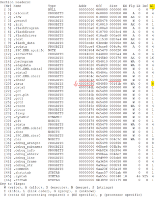

Initialized global/static variables values get allocated in .data segment it turned out that I have an alignment problem, in the beginning, the data section was 4 byte aligned, starting from the address 0x4000404c :
[20] .data PROGBITS 4000404c 05404c 001413 00 WA 0 0 4
and then when I changed that variable,the alignment has became 8.
[20] .data PROGBITS 40004050 054050 00141b 00 WA 0 0 8
Then the .data segment address (0x4000404c) has been shifted by 4 bytes, because of the alignment(0x40004050 mod 8 = 0 )
to be honest, I'm not an expert in memory alignment so I may be saying something wrong.
any help would be very appreciated!

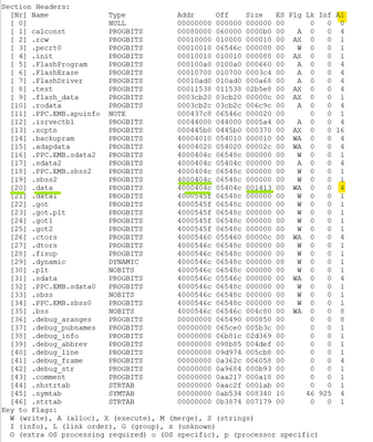

The (initialized ) global data variables are almost by definition in the data section, since the alignment was 4 bytes in the data section, and the VA is 4 bytes aligned, on the other hand, the host can read any 32 bits variable, and everything worked fine. Please find attached a screenshot:
 so the alignment was 4 boundaries.
You can see that the small data sections are gathered together in the program header so single-instruction offsets can access them all.

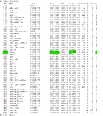

and then , I tried to force that section to be 4 bytes aligned, to ensure that the access to that variable would be fine and no exception will occur, exactly like you said.
.data ALIGN (4): AT (NEXT_LOAD_ADDR)
__DATASTART = . ;
*(.data)
*(.data.*)
*(.gnu.linkonce.d*)
CONSTRUCTORS
} > int_sram
NEXT_LOAD_ADDR = NEXT_LOAD_ADDR + SIZEOF(.data);
and  the bug has been fixed :
  The size of the data section has also been increased by 4 bytes, 1413 - 4 (32 bits global variable) + 8 (64 bits global variable) = 1417 bytes
