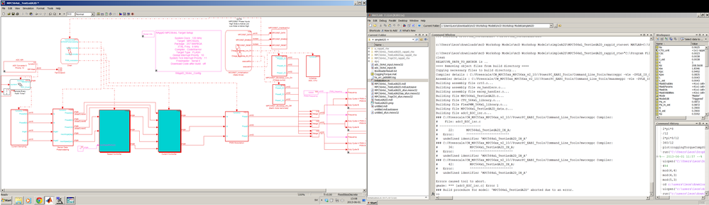

The aim is to use a PWM frequency of 20 kHz, now this would trigger the ADC conversion to have the same frequency. It seems that this process takes up quite a bit of the available computational power. Is it possible to have the ADC triggered, for lets say every forth time? I tried to solve this by implementing logic, but the compilation process encounters problems, please see attached photo.
/Oscar
