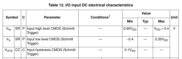

Hi everyone,
I was wondering if there is a way to change the SIU's logical state threshold level for the logical input (MPC5606B MCU)
The high threshold is set by default to 5V. I could not find anything related in the SIU's config registers.
Thanks in advance!
1,977 Views
lukaszadrapa
the input levels are specified in the datasheet and cannot be changed:
Lukas
