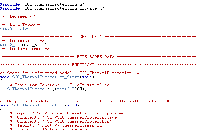

The code is shown below:
                                                                Fig.1   operating result
In the code, variable named "local_A" is always equal to 1, the PC pointer can't jump into the branch.
But actually the judgement  condition is false, the PC pointer is still jump into the branch.  you can see the result in Fig.1.

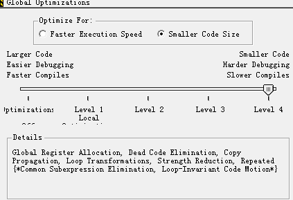

                     Fig.2  Faster build option
If this Global Optimization Settings is set as Fig.2 or optimization level is less than 4, the problem will reappear.
                          Fig.3  smaller code size build option
Only this Global Optimization Settings is set as Fig.3. The problem  will never happen.
3. Question
1)we don't know the mechanism. If we configure the optimization setting as Level4, does it lead other new problems?
2) why other levels lead this problem?
Thank you for your reply.

martin_kovar
could you please share the code of the function, where variable local_A is declared or defined? I also do not see any operations with this variable (something like increment or another mathematical operation).
Martin
2,581件の閲覧回数
朱先生
Hi, Martin:
The variable local_A is declared as global variable. The code is below:
There is no modification about this variable in our code. so the value of this variable is always initial  value "1".
In debug mode, the value of this variable is actually "1".
Thanks for your reply.
