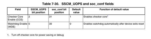

petervlna
Since you didnt share device you are refering to, I will answer generally.
You have status bit for lock step core in SSCM module  SSCM_UOPS register:
I am bit confused what you  want to achieve, could you please explain it in details?
Peter

mehmetkaradag
hi,
the devise i use is mpc5777. i wanna know with interrupt whether checker core is enable.

petervlna
If you want to trigger interrupt on FCCU fault.
 1. Enable the ALARM timeout in the NCF_TOEn register.
 2. Enable the reaction on fault in the NCF_En register.
 3. Enable the alarm interrupt in the IRQ_ALARM_ENn register.
You can refer to :
https://www.nxp.com/docs/en/application-note/AN5284.pdf
Then configure INTC module and interrupt routines according to reference manual for this particular interrupt.
Peter
