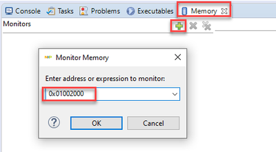

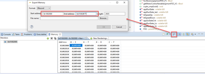

Thanks for your reply. I did manage to connect to the board without flashing code, but I'm not sure how to check the block in question, could you perhaps tell me where to look to find that information?
Also, where could I find another demo project for the inverter dev kit? I'd be happy to try to flash that, but I don't want to flash any random code to the dev kit to avoid damaging it.
Thanks for your help
12,838件の閲覧回数
lukaszadrapa
you can simply watch the memory like this:
And then you can export the memory like:
Well, I'm not sure if this will help but it would be interesting to know what happened there.

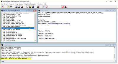

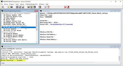

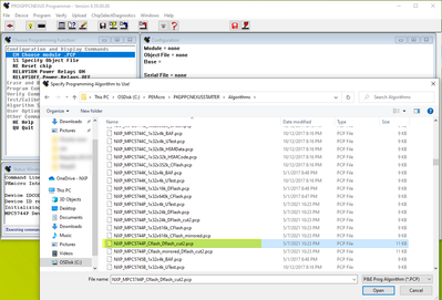

lukaszadrapa
Now I realized that that you probably used ICDPPCNEXUS.EXE because you was talking about reset script. My fault, I should provide more details what to do. Let me describe how to use the Pemicro utility in detail:
1. Run c:\PEMicro\PKGPPCNEXUSSTARTER\progppcnexus.exe
2. Select this PCP file:
3. Double click on Erase module. You should get confirmation in the status window:
4. Double click on Blank check module. You should also get confirmation in the status window:
Is this working on your side? If yes, could you try it in S32DS now?
