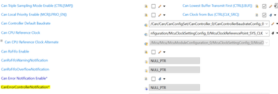

What is the purpose of CanErrorControllerNotification and when it gets triggered?
1,053 Views
PetrS
if Error notification is enabled and callback function assigned it gets called when FlexCAN module detects some kind of CAN bus errors. Check driver manual and device RM for more info.
