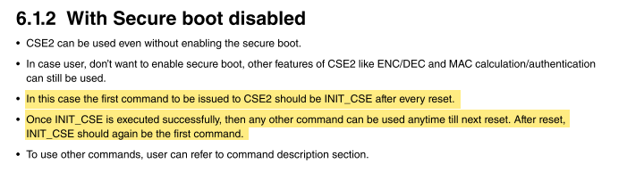

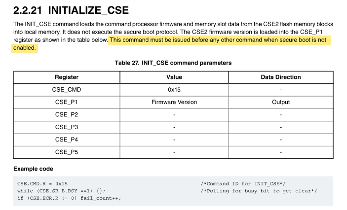

it looks like you didn't initialize the CSE. Let me copy here two parts of the AN5418:
By the way, secure boot is not enabled by default. Read "6.1.1 With secure boot enabled" in the application note.
Lukas

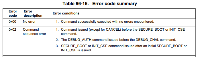

- First performed: INIT_CSE (Called after Mcu_Init in the main before using any CSE Services).
(Result : "CMD Sequence Error" stored in : CSE Error Code Register (CSE_ECR).
Observation : By observing "CMD Seq Error - 0x02" description, Point(3) says clearly that :
- [3. SECURE_BOOT or INIT_CSE command issued after an initial SECURE_BOOT or INIT_CSE is issued.]
Inference: So, as per the above texts, it is clear that: INIT_CSE is not required as "SECURE_BOOT" command is already enabled by default and CSE_Internal Firmware would have issued the SECURE_BOOT command internally.
