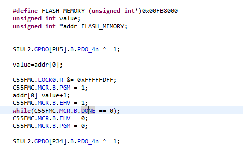

Board MPC5748G
I have problem with flash memory, i use this code, it's just read counter and write to flash memory every restart board.
But this code works only three time, after three time i can't read value from address 0xfb8000. Could you help me?

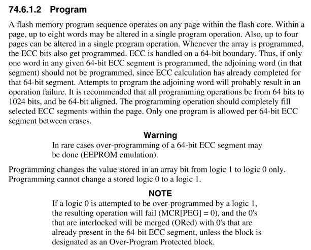

lukaszadrapa
it is not allowed to program a double word which is not fully erased. This over-programming leads to ECC errors:
If you want to program the same double word again, whole block must be erased.
Lukas

yuriy_serdyuk
Hi Lukas,
With erase it works.
Thank you
