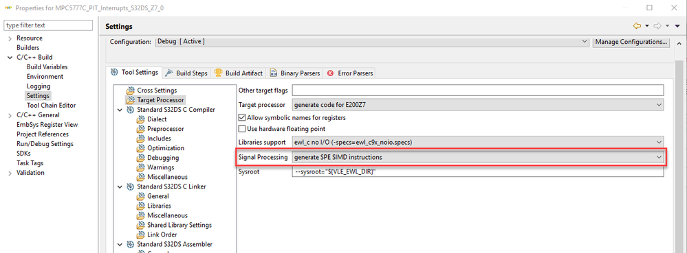

1) If you want to use SPE, there is option for Signal Processing in project properties. Please see the figure below:

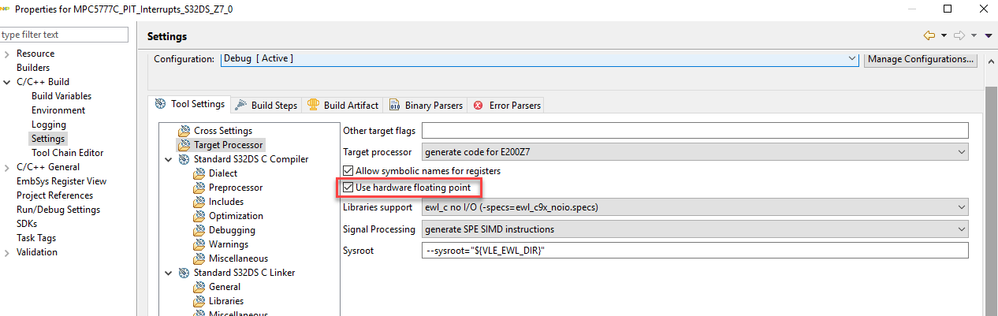

5) Usage of floating point can be enabled by Use hardware floating point option in Project properties.
Hope it helps.
