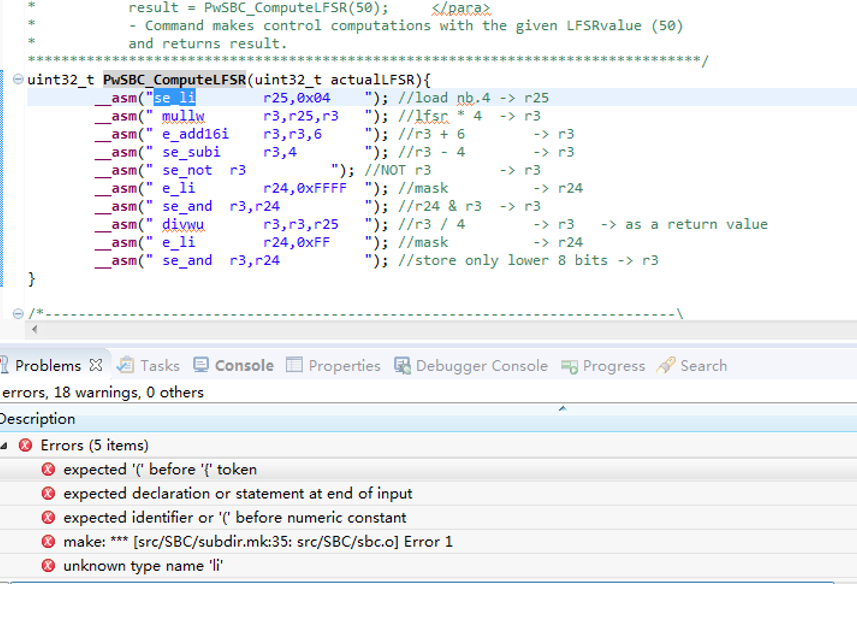

I built a project which is used to driving the SBC MC33908NAE with MPC5744.I met a problem during building the project.The phenomenon is put in accessory file.Can you help me to solve the problem?Than you
1,625 Views
petervlna
it looks like your compiler does not recognize se_li instruction
try replacing it with e_li
