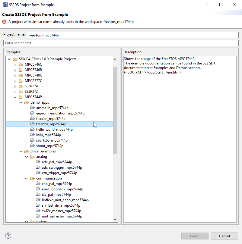

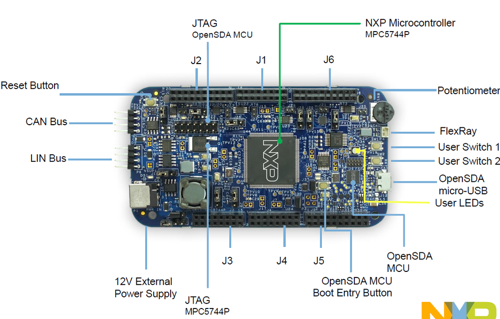

I have a hardwire board : DEVKIT-MPC5744P
I have found the freeRTOS demo in S32DS v2.1.
But I can't run it successfully.
The program will fly if i start the scheduler.
I can't see any led change .
Do you have the other demos? freeRTOS demo for mpc5744.

jiri_kral
please update your S32DS ( https://community.nxp.com/docs/DOC-341068  ) and use FreeRTOS example from SDK RTM v3.0.0:
Hope it helps.
Jiri

475824827
Hi  Jiri.
My S32DS version is S32DS v2.1.
This has SDK RTM v3.0.0.
And I have run this demo ------ freertos_mpc5744p ,But I can't see any led change in my  DEVKIT-MPC5744P.
So I want to try other MPC5744 demos about FreeRtos

jiri_kral
which particular dev kit do you have? On my EVB is everything working as expected.
Jiri
2,913 Views
475824827
hello jiri.
I use DEVKIT-MPC5744P.
