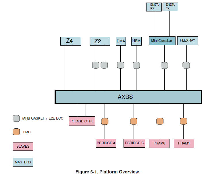

Any idea what AHB MLB and DMC stand for?
AHB_E2E_ECC is a module
MLB is a module
DMC is shown in the figure below
I know there is IAHBG : Intelligent AHB Gasket, but what does AHB stand for?
I have checked the MPC5746C Reference manual and can't find any trace of MLB.
There are a few references to DMC and AHB   i.e. PRAM_1 AHB and PRAM_1 DMC.

AHB = Advanced High Performance Bus (this term is related to system bus connected to XBAR master port)
MLB = Media Local Bus (RM Chapter 50)
DMC = Decorated Memory Storage Controller (RM Chapter 18)
