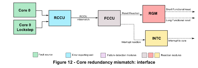

Here is explanation of RCCU faults:
1.1.     Core redundancy mismatch: interface (other than D-MEM or DMA) out of lockstep
This fault is triggered whenever the redundancy checker (RCCU) detects a mismatch between any output of the safety lake and equivalent output of the original lake except D-MEM and DMA.
The root cause can be a permanent or transient fault either in the safety or original lake which propagated to any of the outputs of the lake.

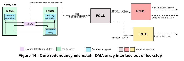

1.3.     Core redundancy mismatch: DMA array interface out of lockstep
This fault is triggered whenever the redundancy checker (RCCU) detects a DMA mismatch between any output of the safety lake and equivalent output of the original lake.
The root cause can be a permanent or transient fault either in the safety or original lake which propagated to any of the outputs of the lake. The DMA array itself is not replicated, but DMA array interface (in other words DMA controller) is replicated.
