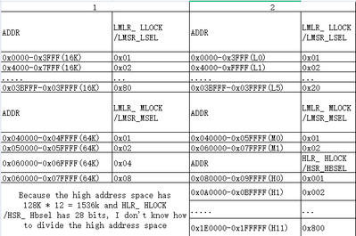

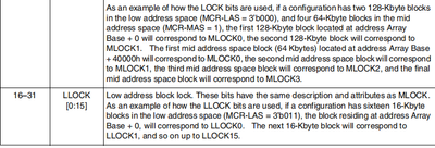

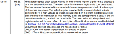

2、In section 13.3.2.2 Low/Mid Address Space Block Locking Register (FLASH_LMLR) and
13.3.2.5 Low/Mid Address Space Block Select Register (FLASH_LMSR) of Flash Programming of MPC5553_4_Reference_Manual,_Rev_31,
In this regard, I have two different understandings, and I do not know which one is right.I list two understandings. Please point out that the right or the two are incorrect.
Lukas
6,996 Views
lukaszadrapa
1. The address must be always aligned to 8 bytes when programming a doubleword.
If you program single word only, the address must be aligned to 4 bytes. But in this case, whole aligned doubleword must be in erased state and then you are not allowed to program second word in this doubleword because it's not in erased state anymore.
2. The bit mapping is very simple, see attached picture.
Lukas
