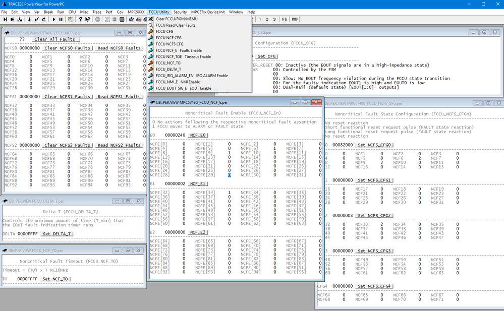

This document describes how to use Lauterbach FCCU (fault collection and control unit) periphery extension for MPC57xx devices.
It is expected that user has deep knowledge on FCCU mechanisms in order to effectively use this extension.
This scripting tool consist of 136 scripts for Lauterbach debugger.
It helps user to quickly debug micro without need of reference manual.
Here is and example of windows that user can use (detailed description can be found in user guide):
