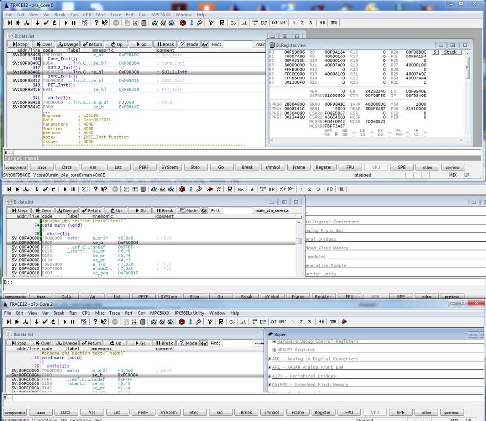

* Detailed Description:
* This example content a basic PMPLL initialization and
* configuration of Mode Entry module and Clock Generation
* module. By default active is core 2 -> e200z4a
* Configure PIT timer to trigger interrupt and service it.
* Example configures start of z7 cores via SW routine.
* Test HW:  MPC57xx MB + MPC5775K-326DS minimodule
* Maskset:  0N76P
* Target :  internal_FLASH
* Fsys:     265 MHz PLL with 40 MHz crystal reference
Revision History:
1.0     Sep-07-2017     b21190(Vlna Peter)  Initial Version
Example also contains Lauterbach multicore script as you can see below:
It will display 3 Power view instances.
