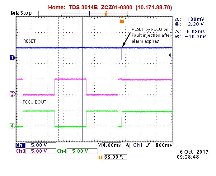

* File:                 main.c
* Owner:            Peter Vlna
* Version:           1.7
* Date:               Oct-10-2017
* Classification: General Business Information
* Brief:                Example contains startup with PLL0 200MHz as system clock
*                          and demonstrates reset triggered on FCCU Alarm state
*                          counter exppire.

Hi Peter,
In this example, you are using the functional muxing (MSCR registers) to confiure FCCU EOUT_0/1 pins as below.
   SIUL2.MSCR0_255[112].R = 0x6|0x02000000;     /* FCCU EOUT_0 , ODC push-pul */
   SIUL2.MSCR0_255[115].R = 0x6|0x02000000;     /* FCCU EOUT_1 , ODC push-pul */
However, the recommended way to do this configuration is by DCF clients. -- Chapter 1.2.10 DCF_ERROR0_PAD_SELECT DCF client, MPC5746R Reference Manual Addendum, Rev. 2, 10/2016.  What's more, in the attached (in RM) "IO_Signal_Description and Input_Multiplexing_Tables", ERRORx is not listed as a muxing function which can be assigned to these potential ERROR OUT pins like PH[0] via SIUL2_MSCR registers.
Best Regards
Yunan
