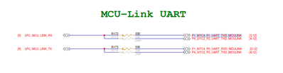

I suppose that you use FRDM-MCXN947 board, from the hardware perspective, the UART4 of MCXN947 is used to communicate between the MCXN947 and debug probe chip LPC55S69.
The P1_9/FC4_P1_UART_TXD_MCULINK of MCXN947 is connected to Uart_RX of LPC55S69, P1_8/FC4_P0_UART_RXD_MCULINK of MCXN947 is connected to UART_TX of LPC55S69.
