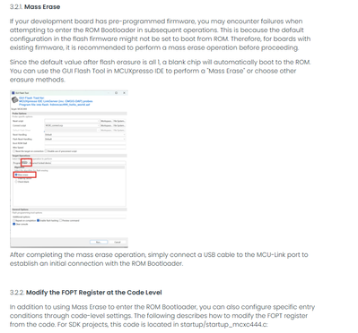

Celeste_Liu
Hello @shivajiyannaboina_tfs ,
For MCXC devices, the SEC tool can only perform operations after the device has already entered bootloader mode.
If you need to place the device into bootloader mode, the SEC tool is not able to perform this step.
Please refer to the links below for two methods to enter bootloader mode.
MCX C: How to Enter the ROM Bootloader to Update the Firmware
Using mass erase method is more recommended way.
Hope it helps.
Celeste
