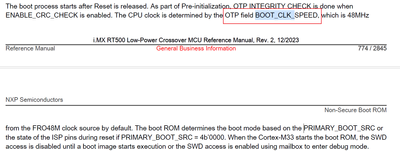

Hi NXP community, I'm working with the MIMXRT595. I saw in the Reference Manual that it mentions a high-speed boot mode. How should I configure or start it?  During testing, I found that the maximum speed for SPI Serial Boot cannot exceed 24MHz.

Regarding your question, to enable high-speed boot mode, we need to burn fuse BOOT_CLK_SPEED.  But the latest RM has little description about it and does not contain the fuse item.  I have created an internal ticket for it, If there is any feedback, I will inform you promptly.
 Take care if the high-speed boot mode is enabled, the power-on voltage need to meet the required.
